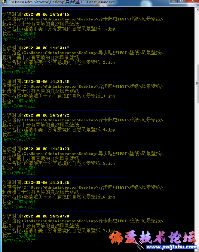

无聊随便写的,供大家学习吧~,希望有大佬帮我改进一下,我觉得还是代码有点
  1. # //div[@class="item_list infinite_scroll masonry"]/div[num]//a/img/@alt 壁纸标题
  2. # //div[@class="item_list infinite_scroll masonry"]/div[num]//a/img/@href 壁纸图片地址
  3. # 总页数440页 [url=https://www.mmonly.cc/gqbz/list_41_]https://www.mmonly.cc/gqbz/list_41_[/url][num].html 页数num从1开始到440
  4. # //div[@class="topmbx"]/a[last()]/text() 壁纸类型
  5. # //div[@id="big-pic"]//a/@href 壁纸高清地址
  6. import aiofiles
  7. import aiohttp
  8. import asyncio
  9. import async_timeout
  10. from collections import namedtuple
  11. import time
  12. import os
  13. from rich.console import Console
  14. from fake_useragent import UserAgent
  15. from lxml import etree
  16. from typing import List,Text
  17. from datetime import datetime
  18. import keyboard
  19. from threading import Thread
  20. console = Console()
  21. headers = {'User-Agent':UserAgent().random}
  22. Img_url_name = namedtuple('Img_url_name', ['img_url', 'img_name'])
  23. Img_big_url_type = namedtuple('Img_big_url_name', ['img_big_url', 'img_type'])
  24. sign = True # 信号
  25. async def get_html(url) -> Text:
  26.     """
  27.     获取网页源码
  28.     """
  29.     async with aiohttp.ClientSession() as session:
  30.         async with async_timeout.timeout(10):
  31.             async with session.get(url) as resp:
  32.                 return await resp.text()
  33. async def save_img(img_url,path,img_name) -> None:
  34.     """
  35.     保存图片
  36.     """
  37.     async with aiohttp.ClientSession() as session:
  38.         async with async_timeout.timeout(10):
  39.             async with session.get(img_url,headers=headers) as resp:
  40.                 img = await resp.read()
  41.                 async with aiofiles.open(f'{path}\{img_name}', 'wb') as f:
  42.                     await f.write(img)
  43.                     nowtime = datetime.now().strftime('%Y-%m-%d %H:%M:%S')
  44.                     console.print(f'[yellow]创建时间:{nowtime}\n保存路径:{os.path.join(os.getcwd(),path)}\n文件名称:{img_name}\n状态:[green]下载完成!\n[gray]提示:按esc退出')
  45.                     console.print('[blue]-'*50)
  46. def get_img_url_name(resp_text) -> List:
  47.     """
  48.     获取缩略图页面的图片地址和图片名称
  49.     """
  50.     tree = etree.HTML(resp_text)
  51.     # 每页有24张缩略图和网址
  52.     img_url_name = [Img_url_name(img_url = tree.xpath(f'//div[@class="item_list infinite_scroll masonry"]/div[{num}]//a/@href')[0],
  53.     img_name = tree.xpath(f'//div[@class="item_list infinite_scroll masonry"]/div[{num}]//a/img/@alt')[0]) for num in range(1,25)]
  54.     return img_url_name
  55. def get_big_img(resp_text) -> Img_big_url_type:
  56.     """
  57.     获取详情页的高清图片地址和图片类型
  58.     """
  59.     tree = etree.HTML(resp_text)
  60.     img_big_url = tree.xpath('//div[@id="big-pic"]//a/img/@src')[0] if tree.xpath('//div[@id="big-pic"]//a/img/@src') else tree.xpath('//div[@class="photo"]//p/img/@src')[0]
  61.     img_big_url_type = Img_big_url_type(img_big_url=img_big_url,img_type=tree.xpath('//div[@class="topmbx"]/a[last()]/text()')[0])
  62.     return img_big_url_type
  63. def mkdir(path) -> None:
  64.     """
  65.     创建文件夹
  66.     """
  67.     isExists = os.path.exists(path)
  68.     if not isExists:
  69.         os.makedirs(path)
  70. def quit() -> None:
  71.     """
  72.     退出
  73.     """
  74.     global sign
  75.     while True:
  76.         if keyboard.read_key()=='esc':
  77.             sign = False
  78.             console.print('[red]正在退出...')
  79.             break
  80. def retry(exceptions=Exception, tries=3):
  81.     """
  82.     重试装饰器
  83.     """
  84.     def decorator(func):
  85.         def wrapper(*args, **kwargs):
  86.             _tries = tries
  87.             while _tries > 0:
  88.                 try:
  89.                     return func(*args, **kwargs)
  90.                 except exceptions as e:
  91.                     _tries -= 1
  92.                     if _tries == 0:
  93.                         raise e
  94.                     time.sleep(1)
  95.         return wrapper
  96.     return decorator
  97. @retry()
  98. def start() ->Text:
  99.     """
  100.     开始
  101.     """
  102.     print('开始页码请不要输入0')
  103.     start_page = input('请输入开始页码:').strip()
  104.     if start_page == '0':
  105.         console.print('[red]请输入正确的页码!')
  106.         raise Exception('出错次数过多!')
  107.     print('结束页码请不要超过440')
  108.     end_page = input('请输入结束页码:').strip()
  109.     if int(end_page) > 440:
  110.         console.print('[red]请输入正确的页码!')
  111.         raise Exception('出错次数过多!')
  112.     return start_page,end_page
  113.
  114. async def main() -> None:
  115.     """
  116.     主函数
  117.     """
  118.     Thread(target=quit).start()
  119.     start_page,end_page = start()
  120.     start_time = time.time()
  121.     for num in range(int(start_page),int(end_page)+1):
  122.         # 网站共计440页
  123.         url = f'https://www.mmonly.cc/gqbz/list_41_{num}.html'
  124.         resp_text = await get_html(url)
  125.         get_img_url_name_list = get_img_url_name(resp_text)
  126.         for img_url_name in get_img_url_name_list:
  127.             resp_text_big_img = await get_html(img_url_name.img_url)
  128.             # 图片标号开始为1
  129.             img_num = 1
  130.             # 图片页码开始为2
  131.             page_num = 1
  132.             while sign:
  133.                 try:
  134.                     if page_num >= 2:
  135.                         resp_text_big_img = await get_html(next_img_big_url)
  136.                     img_big_url_type = get_big_img(resp_text_big_img)
  137.                     img_path = os.path.join('壁纸',img_big_url_type.img_type,img_url_name.img_name)
  138.                     mkdir(img_path)
  139.                     await save_img(img_big_url_type.img_big_url, img_path,f'{img_url_name.img_name}_{img_num}.jpg')
  140.                     img_num += 1
  141.                     page_num += 1
  142.                     next_img_big_url = '.'.join(img_url_name.img_url.split(".")[0:-1]) + "_" + str(page_num) + ".html"
  143.                 except:
  144.                     img_num = 1
  145.                     break
  146.         if sign == False:
  147.             break
  148.     console.print(f'[red]全部下载完成! 耗时{time.time() - start_time:.2f}秒')
  149. if __name__ == '__main__':
  150.     loop = asyncio.get_event_loop()
  151.     loop.run_until_complete(main())
复制代码

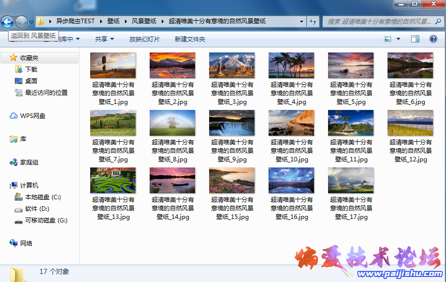

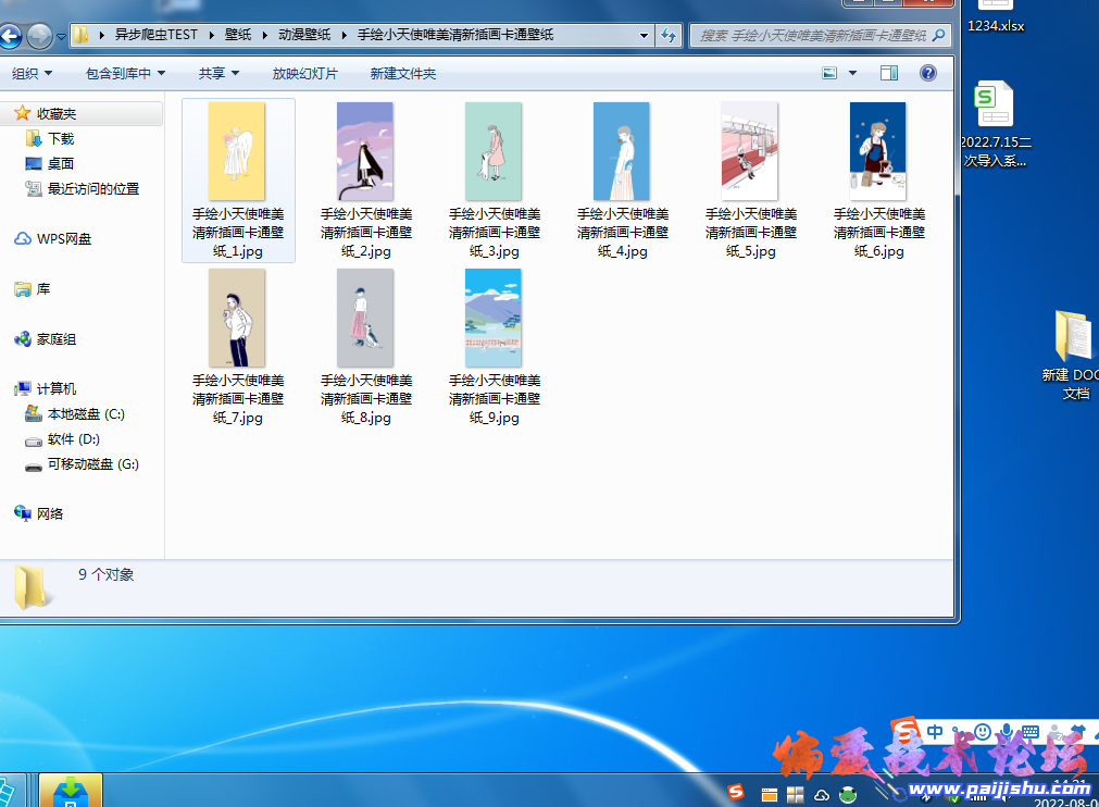

以下为效果
